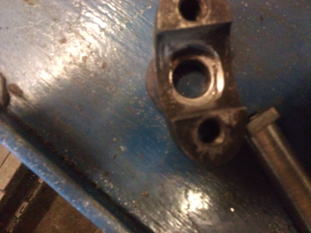

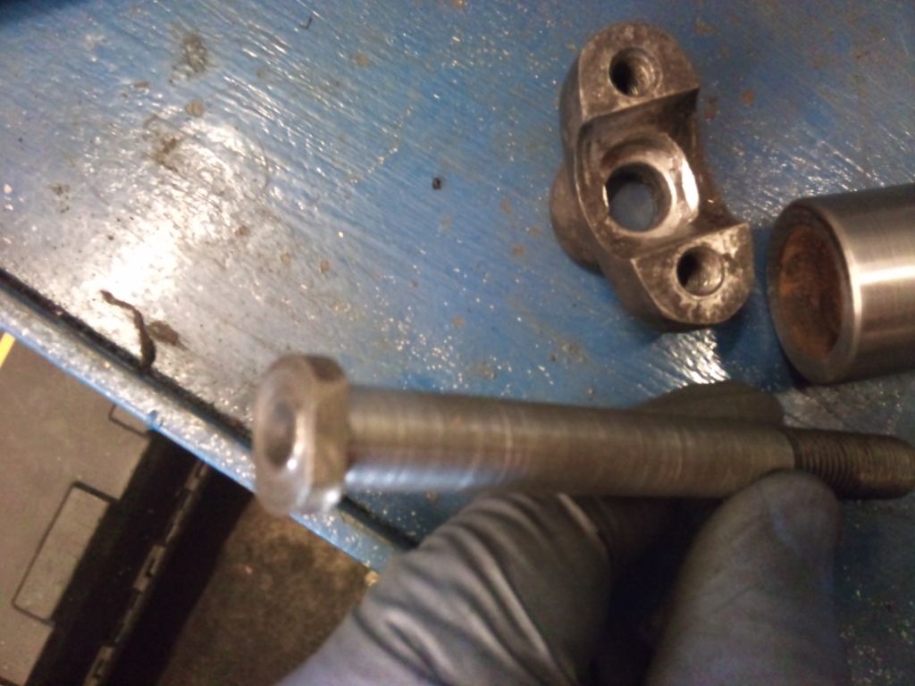

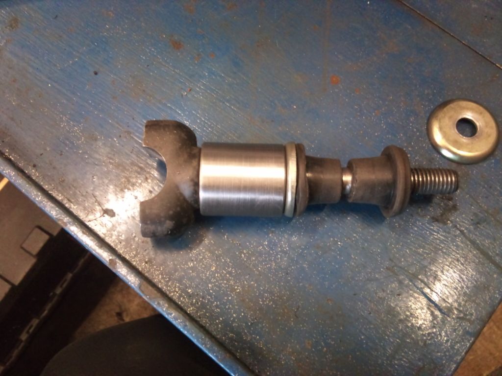

Message par Tommy10bikes le 18/2/2013, 20:21
Hi Leon
I have made the bar riser from solid bar , the clamps are standard XT500 with the centre drilled out.
Maybe the picture will explain better, the bolt is an allen bolt / cap head turned down.
Cheers
TTB
